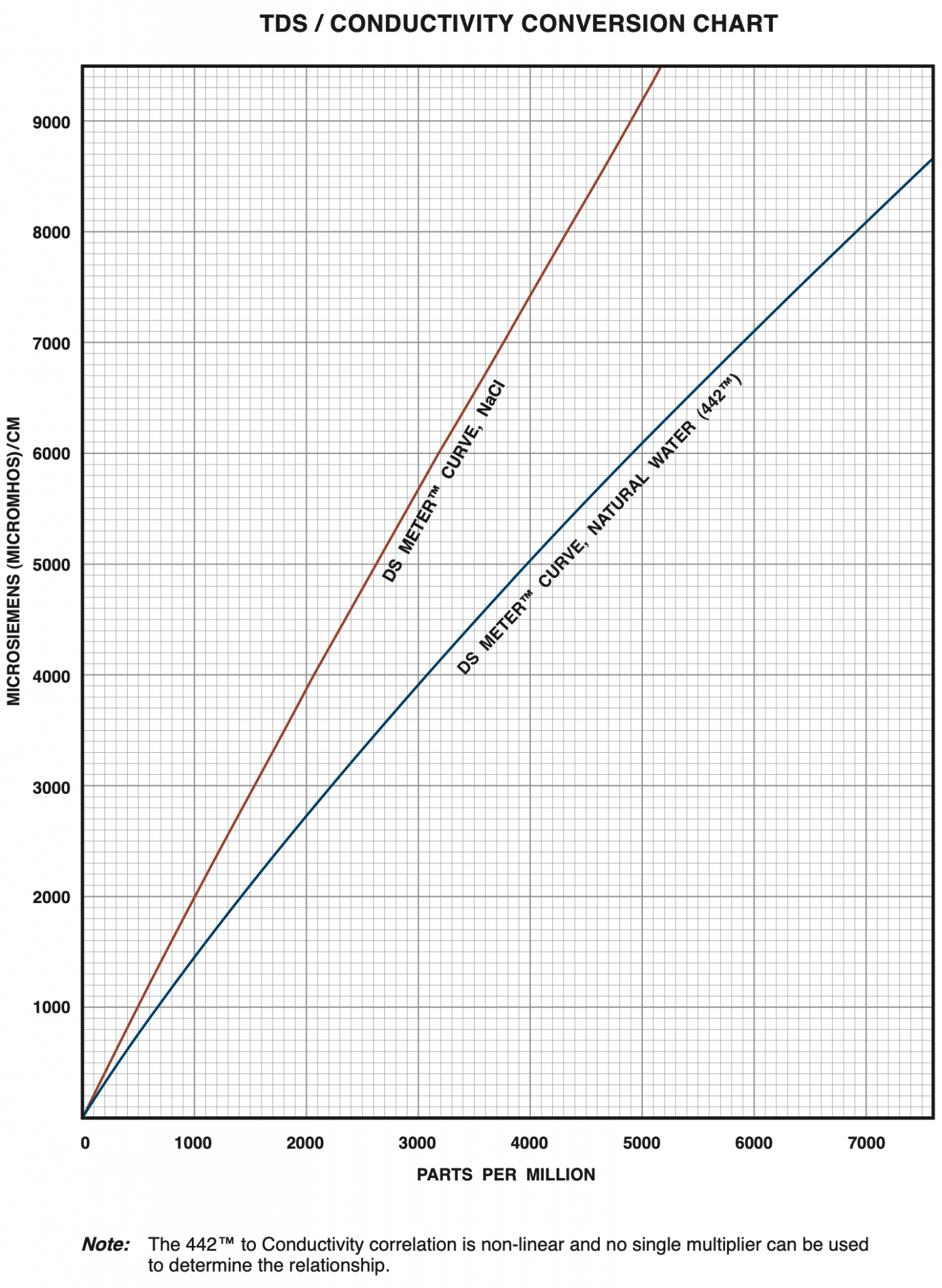

If you get a TDS/Salinity meter, that can give you the best idea about the total amount of ions in the water, but it has to be set to either TDS or Salt (NaCl) and those units are not going to be accurate for your water.
A setting of Salt assumes that all TDS is sodium chloride.
A setting of TDS assumes that the TDS is made of 40% sodium sulfate, 40% sodium bicarbonate, 20% sodium chloride.

If you can test the water using a conductivity meter, this will help estimate the total number of ions in solution.

If you used a conductivity meter on the water and got 2,000 ppm in NaCl setting, then you can convert that to total moles, but 2,000 ppm in NaCl is about 2,900 ppm in the “442” standard “TDS” Setting.
So, you can get an estimate of the total number of moles in solution and then try to balance that against the total number of moles of all constituent ions.
