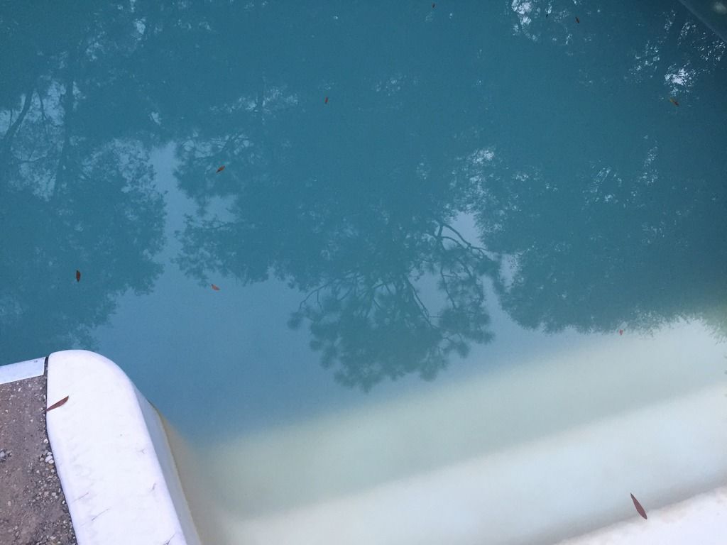

Yeah I'm the same way with being OCD..lol Yes I backwashed for 2 mins then rinsed for 1min then backwashed for 3 and rinsed for 2 mins. I will tell you that sand was nasty and stunk to high heaven. When I was washing out the filter it was dark dark brown coming out. Yes I inspected the laterals and they looked great. No cracks or anything on them.
This is the water right now. It doesn't look as blue as it did earlier but could be due to lighting. Just tested chlorine and I'm at 23 ppm. Will test before bed and add if needed.

Not sure if you tested this but I bet the water pressure out of your pool returns are a lot better now that the filter is clean. I have high hopes for a better looking pool real soon :)

Here is the water today. I think I might do the overnight test tonight and see where I'm at. Its still cloudy but the water is really blue. Here is a picture.
[/URL][/IMG]
FC was at 23ppm when I got home
CC was at .5
When I left this morning my FC was at 24.5 so thats not a bad loss for all day.
