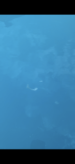

As posted in a previous thread at the end of last season I was battling white water mold as a result of high cya/chlorine issues. My scheduled opening is early May. Took a look at things today. The entire pool is COVERED with white mold. I did test chlorine, ph and cya today .

No chlorine thru frog . Water still passes through it. Switched to liquid ch only, late last year, after realizing High cya is a real problem (despite what the pool store says) . Taylor test kit. Pool was closed in November and won’t be opened for 5 more weeks. The white mold is visible in every inch of the pool . Looks almost like cottonwood while laying on the bottom. Any water agitation from skimming etc sends large shreds that seem to have a paper towel like pattern and zillions of flakes swirling. If I try to grab a larger piece for a photo it disintegrates.
I’m sure this will be a tough process and was trying to look for things I could possibly be doing now
I’m in indiana, I think first week of May is the earliest my pool shop offers openings. Sun wasn’t out much today this is about the best photo I have . If you zoom you can see some of the larger pieces

The longer you wait to fix it the more expensive and time consuming it’ll be to clean up. At least get a sump pump in there to circulate the water so you can get some chlorine in there.
do you mean drop a sump in deep point and pump it out, while adding fresh?
No just drop it down there and let it suck in water and pump it right back out in the same spot. Just to get water moving. That is if you are going to wait a long time until opening the pool.
