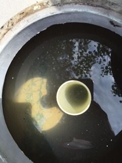

For right now get that piece off of your pipe and see what YOUR sand looks like as well as the pipe and laterals.

I'd try sticking the garden hose in the sand since you've gotten the filter open and everything. The deep clean is pretty simple. Just use your regular garden hose no nozzle, turn on the water and gently move it around the filter. Let the water move the sand as you push the hose sort of in and out and let all the garbage in there start overflowing.
Have you seen the "how to deep clean a sand filter" video yet?
Maybe someone else will have another suggestion but if it was me I'd be dying to get the hose in there to rinse it out and see what happens. I love stuff like that. lol
If/when you do put your hose in there just remember to be gentle. Don't force the hose. You don't want to break any of your filter guts!
Here's the link to which Berns is referring : Deep Cleaning a Sand Filter. I actually think someone posted this link for you a while ago, but it might help to review it.

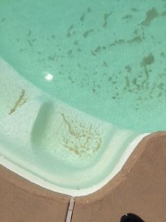

^you can do the OCLT but one of the important criteria of a slam is that the water is both crystal clear AND there's no visible debris/algae anywhere at all.

I will add some DE after work today and take counts again and continue to SLAM. I still don't know what the debris/algae is on the bottom that keeps coming back. I did vacuum it but looks like still there. =-(

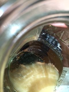

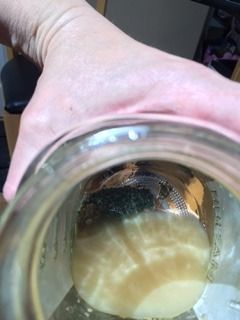

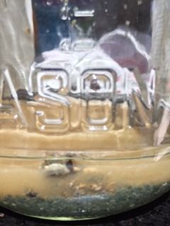

I don't know why but I thought if you could scoop some out with a little kids beach shovel or something like that. Just to get it out of the water so you/we could look at it better.
Also a thought. What if you vacuumed it out and then let your pool sit for a little while without running the filter? Does it come back? Do you know if it's coming out of your returns or not? Or is it just something that is in the water and settles down to the bottom? Maybe dead algae?
That's why I say maybe try and get a scoop of it. Did your sand move around and seem loose when you put the hose to it? Was there any hardness to it if you put your hand in it? Like maybe sitting on the bottom of the filter?
