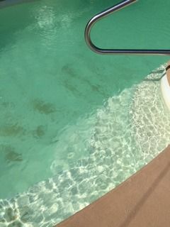

New counts:
42x.5 = 22.5
CC = .5 (I think - I think it was the very slightest pink but not sure)
LMK if these photos help.
THANK YOU

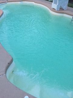

New Counts:
FC: 40x.5= 20 (that's good, no? - it stayed and didn't drop overnight)
CC: .5 x1 = .5 (I think)
http://i725.photobucket.com/albums/ww258/jenmazz/IMG_7684_zpsodw0ijhv.jpg
http://i725.photobucket.com/albums/ww258/jenmazz/IMG_7687_zps4f2j9ftu.jpg
Thanks
Jen
Look at that water! You are doing great with getting the pool back and diligent with testing and it shows!
I bet you will have decent holds today. It is normal not to lose anything at night when there is no sun and the leaches not eating anything. The water is almost there.
D

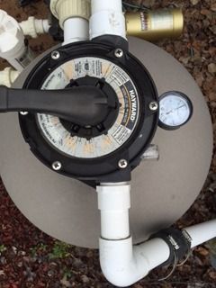

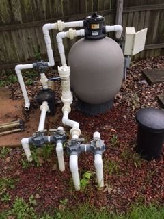

Here are the photos of the filter. I have to run out to my sister-in-laws - we are making a weighted blanket for an 8 month old that we know that has major heart issues. I should be home around 4 or 5:00. Does that work? Or if you are able to look at the photos and LMK your thoughts? The two pipes on the left is the pump and the skimmer. The two pipes on the right are for the jets in the seats of the pool.
LMK your thoughts. Thank you!!!!
New counts:
43x.5 = 21.5 FC
.5x1 = .5 CC
I see unions! That will make your filter looking/cleaning SO easy!
See those white circle things on the left of the filter? Those are unions. You can turn the outside (lefty loosey) ring and slid it back out of the way and your filter top will be free from all of those pipes.
I cannot see what is on the right side but I am hopeful that it has unions also.
Step by step:
-turn off pump
-close all values to off to stop flow of water out of the pool.
-loosen the unions
-turn the ring that is holding the top of the filter onto the sand tank
-carefully lift the top off and set it aside using care
What you are looking for is the sand inside the tank. Is it loose? Does it move when you put your hands into it?
You can gently run a water hose (with the water running) into the sand. That will flush some stuff up and out of the tank.
Sometimes the sand channels so cannot do it's job. You can loosen it up so that it is able to work again it that happened.
I do NOT want you to take the sand out at this point. You are making great progress with your pool clearing and I do not want that to stop.
Do not do anything if you are at all unsure what you are doing. We can walk you through it.
