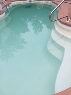

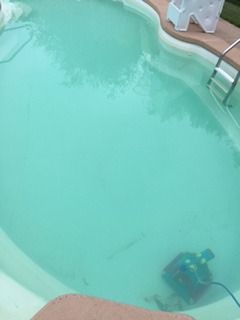

Okay, pool was off all day and no stuff on bottom. Turning on pool now. New counts:
FC = 30x.5 = 15
CC = Zero
Adding 85 oz of bleach.
Water is clear - tint of green/turquoise.

So the stuff that shows up on the bottom is from the filter. Whatever it is - but it is not the hard sand granules. It looks like the stuff that I saw on top of the sand in the filter - it was brown and looks like what is going in the water. Under the brown layer in the filter is the turquoise looking sand.
Any thoughts on what that is????

What a improvement! It could becoming from the filter if it is there again. I get sand from my filter.
^ Not so sure about that. It would be highly unusual if that were the case.
Jen, did you run the robot/cleaner at all today? Or did you have it completely off and no filter and no stuff on the bottom?
Do an OCLT tonight and post results please.
It is def. has improved! =-) The stuff is coming from filter. I did already pay for new sand and want to change it out and also add a little DE with the sand. I don't know when the sand is coming in though. I do remember that when we did our walk through of this house, that the pool had this in it and I thought it was just dirt. I think previous owner must have had this issue - since I recall seeing it before we bought the house. Is there supposed to be a layer of brown stuff and then the sand under it?
