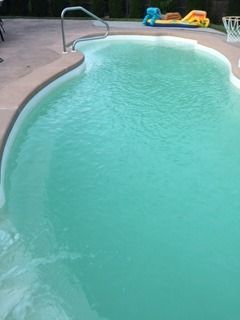

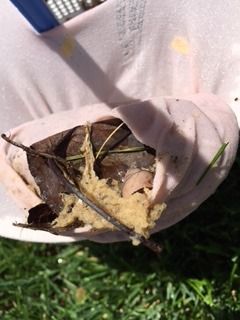

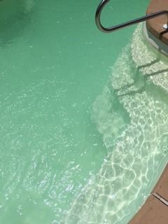

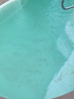

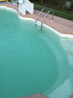

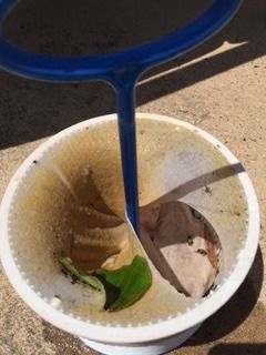

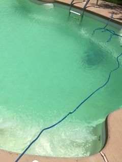

Riddle me this Batman.....LOOK at this in the skimmer - what type of algae is this? Yuck! Pool water looking better. In the photos I have the Dolphin vacuuming the pool. Our hand vac - that the other owner left, broke. LMK what you think of the algae photos and here are the counts too for now:
FC = 32 drops x.5 = 16 ppm
CC = 1 drop x .5 = .5
Adding another 8.5 cups of bleach now. I cleaned out skimmer too.
http://i725.photobucket.com/albums/ww258/jenmazz/IMG_7671_zpsvp3vohro.jpg
http://i725.photobucket.com/albums/ww258/jenmazz/IMG_7677_zpswihm76hf.jpg
http://i725.photobucket.com/albums/ww258/jenmazz/IMG_7679_zpsfqffjkcz.jpg
http://i725.photobucket.com/albums/ww258/jenmazz/IMG_7678_zpsxyvp5az2.jpg
http://i725.photobucket.com/albums/ww258/jenmazz/IMG_7676_zpsafbfbijd.jpg
http://i725.photobucket.com/albums/ww258/jenmazz/IMG_7670_zpsmkzsz6ae.jpg

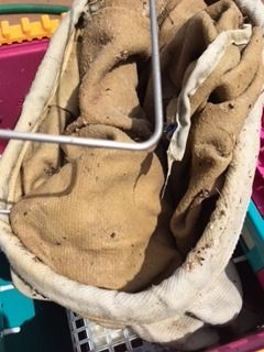

I didn't feel it and already have cleaned it. I looked in skimmer now and there isn't any again yet. When I did find it though, it was very clumpy in the skimmer sock. I'll be sure to see the Dolphin vacuum - what it feels like in there if I can see it on the bag.
Ok got the vacuum out and looked in the bag - lots in there. I was able to feel it - not slimy. Soft it seemed and a little gritty. It was hard to tell but wasn't slimy. Here is a photo.
What does that tell us?

VERY good news!
It means you are well on the way to a clear pool.
Do NOT stop! You still have to get all of that stuff off the bottom and the water so clear that you could read a coin in the deep end.
It might go back up once or twice but that is no big deal. It just means the beach found something else to kill.
Kim
It actually reminds me of the pollen I caught in my skimmer sock about a month ago when the pollen was really bad in my area. It was kinda spongy feeling.
Either way, the way to prevent algae is to maintain your FC at the proper level for your cya. (after your SLAM) As long as you keep your FC where it's supposed to be you won't have to worry about algae anymore!
For now keep on with the SLAM process! Your pool is really starting to look nice!
I do see a slight improvement in honesty. Today is really only day 3 in the SLAM process as you were greatly slowed by the lack of reagents. It likely took some while for the algae to grow....it also takes time to reverse that. I'm seeing small improvements in both your numbers and the photos. Hang in there.
As for the stuff you found in the pantyhose. You described it as "gritty" not slimy. To me that description points to dirt or sand. Often algae is a slimy and pollen is squishy. Keep brushing and it will clean up.
Jen look at all of the progress you have already made! Keep the work up and it WILL clear up! I hate that it is taking so long :(
