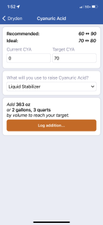

Another newbie question.. what do I actually buy when I go to store for a liquid stabilizer? Is there a brand or product recommendation?

You can buy stabilizer and acid and chlorine at Lowe’s//HD/walmart/ace in the Houston area. I prefer the HTH brand CYa sold at Ace but it’s all good. Look in the garden sections at Lowe’s and HD for pool chems. At Ace everything but acid is in a pool aisle but you have to ask for acid behind the counter.
Leslie’s will be expensive….

Do NOT bring your CYA up to 70 at this time.. Bring it up to 30 or 40 now and then wait a few days and test it again. Once you get 40, then bring it up to 60.. A little at a time is better than all at once.

I'm confusing myself so I apologize if the question has already been answered. So, first, do I put in the dry chlorine using the sock method? If so, Pool math is telling me that I need 8lbs, 12 oz to reach a target CYA of 70.
Another post says I need to raise my FC to at least 5ppm. I know there's a relationship between CYA and FC, but while the dry chlorine achieve both?
When I enter my stats into Pool Math (CYA=0; Current FC=1.5; Slam target 3; SWG Sanitizer; 24-hour SWG output= 1.4; Pump Run Time= 12; It says run my pump 12 hours with your SWG Cell at 27% (I don't know what that means).
