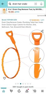

I don't recall for this one but Amazon has many choices under "drain hair snake" that look very similar.
FATHER.SON Drain Clog Remover Snake, Plumbing Toilet Hair Snake Drain Cleaner Auger Catcher for Kitchen, Sink, Bathroom, Tub, Shower(4 Pack 20inch) Amazon.com
Reactions: proavia
