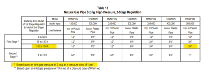

There is also 2 psi "High Pressure" available from some utilities and that has its own design requirements.
For example, a 3/4” line at 2 psi can supply 500,000 btu/hr at 150 feet long at a pressure drop of 1 psi.
1 psi is 27.68” w.c, so you still have 27.68” w.c at the regulator near the heater for 2 psi (high pressure).

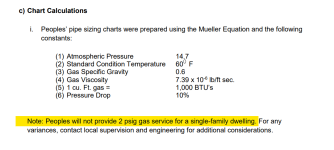

It looks like the OP's utility does not offer 2 psi service, but they can check if they think that that would be helpful.

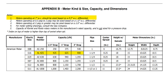

For the AL-425 meter, there are three different ratings based on the allowable pressure drop.
425 CFH at a 0.5” w.c drop.
583 CFH at a 1” w.c pressure drop.
898 CFH at a 2” w.c pressure drop.
For 1.25” line, the pressure drop is about 5.00 milliinches per foot of pipe for a flow of 400 CFH.
So, the length of line that is acceptable depends on the allowable pressure drop.
If you allow a 500 milliinch drop (0.5” w.c), then the length is limited to 100 feet.
If the line is 150 feet, then the pressure drop is about 0.75" w.c, which is not too bad.
So, the 1.25" line would probably be fine and the pressure would not drop too low.

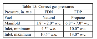

For example the Avia 404 shows a range of 3.5 to 10.5” w.c.
If the pressure starts at 7” w.c, which is typical, you can allow up to 3.5” of total pressure drop across the meter and the line.
