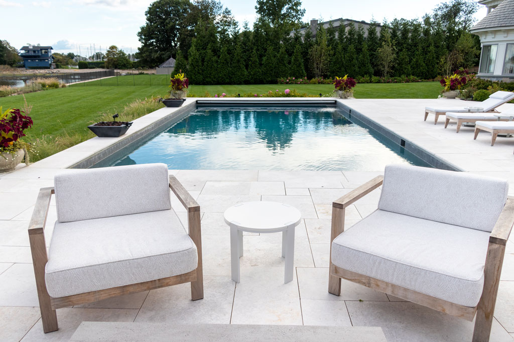

We have sand blasted marble and it does not get hot at all. Does not get slippery either. It does cause the kids toes to bleed when they swim all day, but it's new so I am hoping their skin will toughen up. I tell them that it's part of having fun and they don't really complain. :mrgreen:
It does get stains from leaves and other organics. We get a ton of sun on the pavers, and the sun bleaches the stains out in like 48 hours. But the stains might be a concern for shady areas.
***Edit*** disgregard the floater. We are still in startup and the PB is in control.
@JupiterFL - What a gorgeous pool!
Excuse my ignorance, but do you happen to know if sand-blasted marble much more expensive than travertine pavers? I wonder if your deck stays cool because it's marble, or because it's such a beautiful white color.
Also - is that real grass or artificial turf? It looks great. Maybe we should do that too...
Thank you. There are a few things I wish I did differently, and would have if I found TFP before we started the build.
The sand blasted marble was $2/sf more than the travertine. I am not sure about the material vs. the color. Although, marble probabaly doesn't come in many colors.
Artificial turf. It's great. No dirtty feet.
