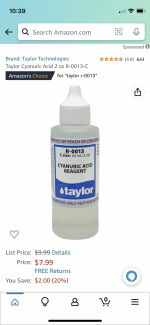

You should order more cya reagent - if you ordered on amazon they often give free shipping for anymore orders in the next 24hrs. You may want to confirm that your cya tube & squirty bottle are the same as the taylor ones, if not replace them- mine were but that was years ago. I buy the big bottle because it’s cheaper & the cya reagent lasts a long time if stored in a cool dark place.
Is this it? Can you send link or picture so I can be sure I’m getting the right thing?

I thought it had to be the Taylor bRand
Tftestkits uses Taylor reagents.
The TFpro and TFpro salt look expensive but both come with a $48 stirring device that the K2006C doesn't. They are the better value when the stirring device is added to a K2006c.
Trust me Eredwood, you want the stirring device. Nobody. And I mean nobody. Would give theirs back if they had one. They'd fight for it. Dirty if need be.
