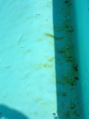

Here is a picture of mustard algae:
This was taken relatively early on, when it had just taken hold and hadn't spread too much. It started along that edge, which is the most shaded spot in the pool, and was on the walls nearly as much as it was on the bottom of the pool.

Hi there. I'm new here but wanted to chip in....that image is identical to the stuff that was on the bottom of my pool a couple times last year. We had a vinyl tear on the bottom and after I repacked the lost foundation, sealed the bottom and refilled the water the liner "slid". So I have slight overlapping folds on the bottom in a couple of places now and that gunk started showing up. I scrubbed/bleached it away whenever it came but the past winter....well....it was free to do what it liked right?
