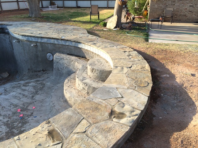

Indeed it is, and we are putting in far less than most folks. It's about 3 1/2 pallets worth. Lots of waste with flagstone. Normally about 1/3 according to the PB, but I think they are doing a good deal better than that.
Flagstone is pretty much done. I have been concerned about the skimmer tops for some time. I kept wondering how well they would put them in and how much they would stick out like a sore thumb. So I came home last night and found out. Here is what I have been worried about the whole time.
My wife had already seen this and was very excited about it, and honestly I liked it quite a lot. I had no idea they would do this and it was never discussed. I can say I am very pleased with the choice. None are complete, but this is such a good alternative to the ugly skimmer lids sticking out. Actually I love it!
This one will get cut out today I suppose...
This one will be worked on the underside until it fits flush...

I think they bevel out some notches on the skimmer holes, and the undersides of the lids to have access for removal. Not sure but hopefully I'll find out this evening.
Dave, (pragmatic) they put a few pieces on the thin set mortar, then use boards and levels to get them evened out. Doing only a few at a time it's pretty tedious but it sure comes out nice.

It looks like they are doing a great job, just taking too long to do it. That's a common theme on pool builds. The flagstone really came out well

Looking great! I really like the flagstone. Super nice!
