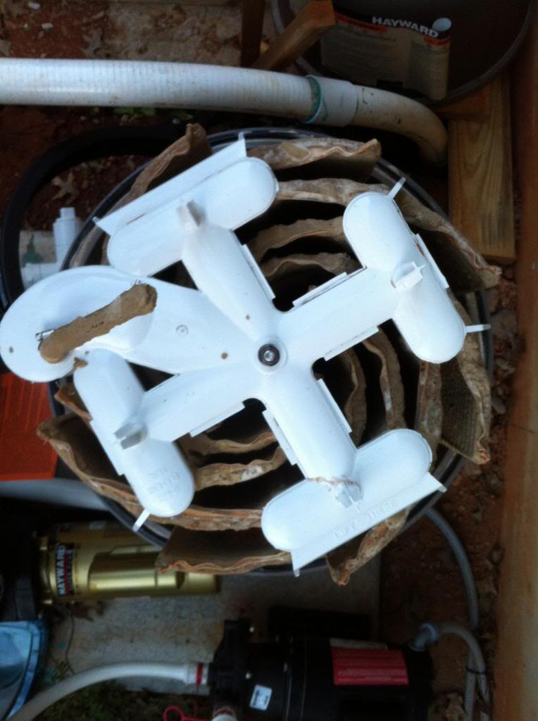

I used the instruction in this thread to clean my filter out yesterday. Everything worked perfectly. Here are some pics.... EDIT: this is the first time i've cleaned it, it's been installed for ~1 year. The source of any red tint is Georgia Red clay that blew in during the landscaping.
OMG it gets THAT dirty?
Sorry no clean filter pictures, but it was almost as clean as new. I'm not sure if i had any calcium buildup, it a liner pool, but it was cleaner after acid soak. My acid ratio was not as strong, 1 gallon acid to 40 gallon water.
I could believe all that nasty stuff i saw when it was soaking in TSP....this is gonna happen AT LEAST yearly, maybe half way through summer too!
