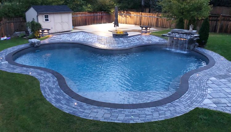

I’ve done a lot of searching and I’m not finding much luck so thought I’d try to ask directly. We are getting a new liner and I want to avoid the same mistakes. It’s hard to see the normal waterline but you can see the original liner color (vinyl loop-Loc dark grey granite) above the waterline, a fade below the waterline and then another shade lighter below the water line when the pool is closed and drained below the returns. Since the pool is being drained for the new liner, I can see something is happening whether it’s all year round or just after closing and I’m curious what chemical imbalance is causing it? Im sure That if I just follow the guidelines here all will be ok but for my knowledge, I’d like to know the root cause.
Located in NY, SWG, Mesh cover is on during the winter and the pool does refill to the top from rain and snow throughout the winter before opening.
Any insight is appreciated, just looking to know what caused it. I originally hired people to close my pool but that doesn’t mean it’s not from me either. I’ve always circulated all the chemicals for 24hours before closing but I never tested and balanced after it was winterized. Not sure how to accomplish mixing everything in when it’s winterized.
Hey J !!!! While the FC may have reached damaging levels over the liners lifespan and bleached it, its usually an ink problem and not a chemistry problem. Quality liners fade less, which loop loc certainly applies, but darker liners tend to fade more, even from the quality makers.
Was it noticable when under water ? Many times some fade doesnt appear so when its wet, or not as much so.
Thanks for the reply! I guess i'm hoping it wasn't an ink problem but i'm not surprised either. It became noticeable over time, more at the start of each season i'd notice it more and then would look back. The actual telling sign was when I could see the imprints of our ledge loungers where the fading wasn't as significant, then I needed some patch work utilizing the extra liner I had and that's where I noticed it the most.

Here’s an updated picture of the liner. You’ll see a patch of the original liner that was installed at the beginning of last season, it’s been my way of seeing that I’m doing what’s right versus the PB. It’s just crazy to see 3 different lines of fading but it is what it is. 2CBE8857-291B-4771-AFFF-A6033C5B94FE.jpeg

All liners fade, and in places like the southwest, they do so in a week. We fare a lot better in the northeast. Personally I would never buy a generic liner, even if I could prove it was made and resold by one of the big manufacturers. (Looplock, Merlin, GLI, Latham). There would be no guarantee the sister brand got the same materials and quality control.
But chemistry can play a big part as well. Particularly how people 'used to do it' when we meet them. So how'd you manage the pool previously? Most subscribe to the once weekly shock method which is terrible for liners. Then for closing, they spike the FC again. We affectionately refer to both as the dump and pray method because they aren't measured or controlled. Without understanding what FC levels are safe because of your CYA level, there is a good chance you or your pool people bleached the liner some.

Thanks! yes I definitely expect fading, this liner and pool was installed in 2018 and the fading feels excessive. I never had or understood a pool before that so we went with a company to maintain everything. They had the SGW at 95% and would shock like crazy. I used strip testing and ended up lowering it to 85%, still not understanding anything. Fast forward a couple of years after watching them and decided to take everything on myself at the opening. I've been maintaining since 2020, but that was a learning year. I put CYA in after I noticed chlorine wasn't staying in and ended up lowering the SWG to 35% after seeing that it was sufficient. It was a real learn as I go that year. 2021 I bought all of the regents and proper testing and while I put CYA in, I didn't pay attention to keep the level up and same goes for the CH. I just worried about PH and Alkalinity the most. I'm prepared this year to keep track of everything from the charts, have the app and all of that jazz. I prefer not to shock if I don't have to, I'm hoping the non chlorine shock suffices if necessary.

It sounds like you had a runaway SWG and the pool service was fine with an out of control FC so they could show up less often.
This liner should fare better than the last. Ask any questions at any point and we'll help you stay within the Recommended Levels
