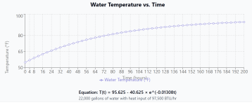

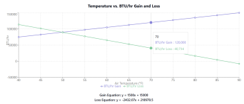

80 Air, 80 Water and 0% humidity = 97,941 btu/hr
80 Air, 80 Water and 100% Humidity = 156,765 btu/hr.
Difference = 58,824 btu/hr.
That is about 60.64 lb of water or about 7.2 gallons of water difference.
Each 1% of humidity makes about 588 btu/hr of difference.
Line Equation: y = 588.24x + 97,941.18
The state with the highest average humidity in the US is Alaska, with an average annual relative humidity of 74.3%.
Conversely, Arizona is the least humid state, with an average annual relative humidity of 40.4%.
Alaska: 74.33% (141,665 btu/hr).
Arizona: 40.38% (121,694 btu/hr).
About 20,000 btu/hr difference from the most humid to the least humid assuming 80 air and 80 water temp.

Note: Line extended (Extrapolated) from the two given points.
Most likely, the values +/- about 10% on either side are probably pretty accurate.
Humidity down to 0% is assumed to be pretty accurate, but we do not have actual numbers from testing data.
In any case, most places will have a humidity close enough to the known points to have usable data.
