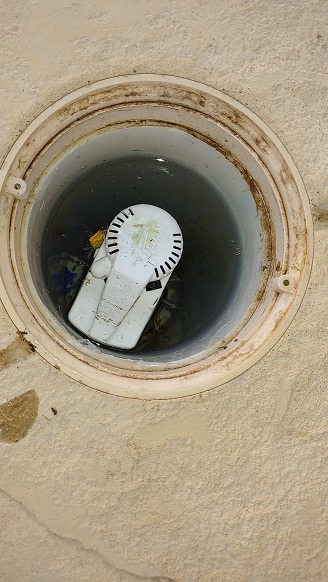

And here ya go...this is the lid
This is inside the lid (apparently I need to do some cleaning in there)
and this is where the water comes out...notice it's below the skimmer intake a bit but that doesn't matter as long as the water level in the bucket is kept high enough.

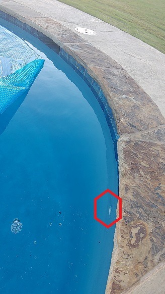

Walk straight from it toward your pool and see if you see something like a return in the side below the water line. Take some pics of the deck and the side of the pool that the line is on.
There is no type of return line anywhere below the water line (besides the 4 from the pump).
That is a jet output in the 2nd pic.
