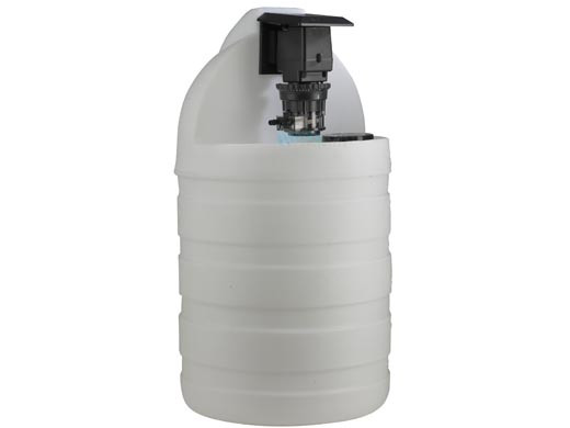

Here is a tank and pump combo for $538. They have gone up quite a bit.
However, make sure you aren't able to use a SWG. That is an easier option.
And, you might check on a source of bleach in your area.
