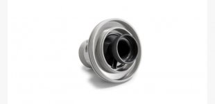

I’ve looked and can’t find anything. The ones I do find, say they work with a 1.5 inch return. My pool has this for the return. The inner thread is 3 inches and the outer is 4 inches. Has anyone found something that works, or something you have made?

we have the same attachment to the pool. How did you build the sprinkler?
Sorry for the late reply. It was a crazy day around here. I took one of the black rubber plug things and cut the tip of it off. I unscrewed the cap on the return, placed the rubber plug on the inside , with the tip pointing towards the pool. I then placed the pvc pipe inside the rubber plug where I cut the tip off. I had to use some electrical tape to keep it upright. It’s been working fine though.
