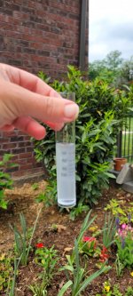

dusty, light yellow looking film
Once you complete the SLAM, do the one day Mustard Algae protocol. See Mustard Algae
If you have items pertaining to the fiberglass shell, post in Everything Else those questions. @Texas Splash has a fiberglass pool and is a great resource.
I'm just totally at a loss today. The yellow seems to be coming back faster in more places on the wall. We were overwhelmed with pollen yesterday, but I really don't think I'm seeing pollen on the walls of the pool inside the water.
First pic is the waterline this morning. Pool was open all night. Next are what the yellow stuff looks like.
I feel like this is going to be neverending.
I redid the CYA test and got close to 40.
Camera doesn't do justice to the color of the yellow dust stuff that I've suspected is mustard algae.
