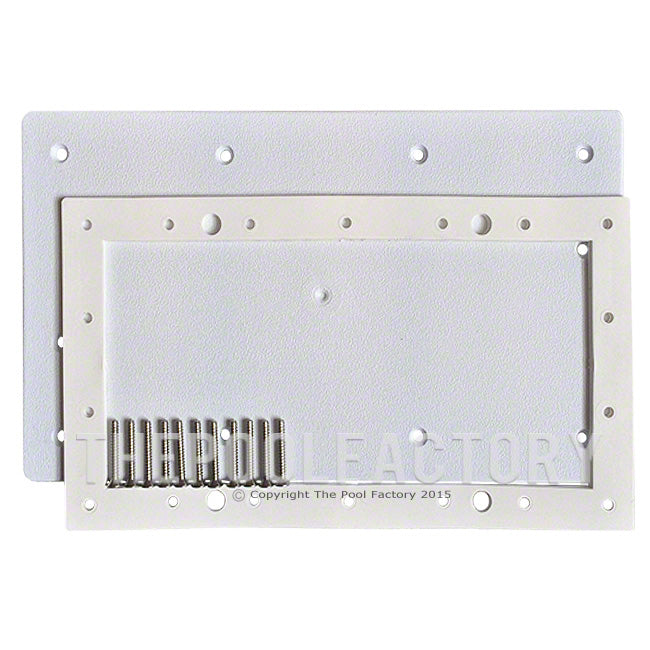

You said plug but do you mean plate so you can keep the water level in the pool at normal height without it entering the skimmer box?
If so this is what you need- it should fit all the ones they sell
Otherwise, you can drain the water in the pool an inch or so below the skimmer & leave the bottom of the skimmer open (removing the hose or pipe) to prevent water from accumulating & freezing in there over the winter as Tex mentioned.
They make skimmer plugs too, that is what I use. I used to use a plate - take out every other screw in the faceplate, and use them to attach the solid faceplate.
Now I use a plug like this. Just pops in. I have not had a problem in 3 seasons with it. I also remove and store my filter & pump and leave the suction line open, so anything that does get in the skimmer body can drain.
