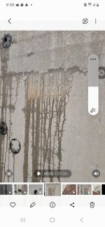

Hello, I thought I might post some images here. I had a pool shot. They turned up short handed. 3rd truck left with concrete fine of last load just got it with a long wait to clean the pump of off concrete (cold joints) shapers were finishing in the dark. Bench has a bow in it. Floor a mound and scaling as they dumped a sand plug there. Bench has holes in it. Did went wetting for curing. Fast forward 3 week we took the out of ground section form work down and most of the bar chairs have no concrete. The highest part of the pool at the corner has voids, pipe work is exposed and when I put the hose in various holes the wall lit up with cracks and water flows out of sections. What to do?

The back half is in ground shot against rock. The front wall on a deep pier footing. The out of ground section that is highest is basically hollow. It seems the shotcrete did not get past the reo in alot of that area, they were rushing this section as the truck was going off. Put alot of water in the mix to try and get it out. I put the hose in a hole in the outside of the wall and water leaked into the pool on the inside. I'm assuming this wall needs opening and loose material chipped out and boxed up again for structural grout?.

That weeping is from that water I put in the holes to try and see if they were very big. Turns out they are, one of those cracks follows a pipe that is imbedded in the wall. The other appears to be on a cold joint. Yes, reo I mean rebar. The first holes I saw were the bar chairs as isolated holes. The deep end is actually huge cavities behind a thin skin that was formed on the formwork. Behind that skin are holes/voids/cavities. The shotcrete company intercepted the tickets from the trucks so I dont have any.
