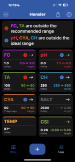

Picture attached is my readings after the drain and refill. Couldn’t test CYA because it is after midnight so no sunlight. I put 58 ounces of liquid chlorine in for tonight and will do all the test again tomorrow with CYA.
Once I get that I will know exactly how much dry stabilizer, liquid chlorine to hold around 5 and then salt after that.
Anything that I am missing or should be concerned about?

Before you test make sure the pump has been running for a good couple of hours to get a good mix. Not sure what you mean with ''hold around 5" because the target for 60 CYA is 4-9 but you don't really want to be at 5 but rather at the safe spot of 9. Also your CYA should be somewhere 70-80 this time of the year which has its target at 5-10.

I will have to test the CYA in the morning so that reading of 60 was my last reading before the drain and refill today. The refill did not finish till about 11 pm tonight. I will run a full test in the morning to have better readings. I will post them in the morning. I am leaving the pump running all night before testing again so they should all be more accurate. I probably should have just waited to post anything till then.

Good job getting it drained. Now you just need to get your Salt and CYA levels adjusted. You CH level came down to just about the minimum level which is a good starting point. Turn off SWG while adding salt to avoid high concentrations from entering the cell.
