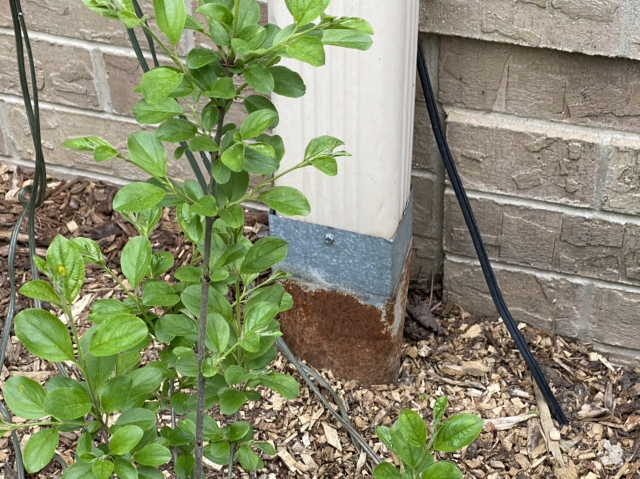

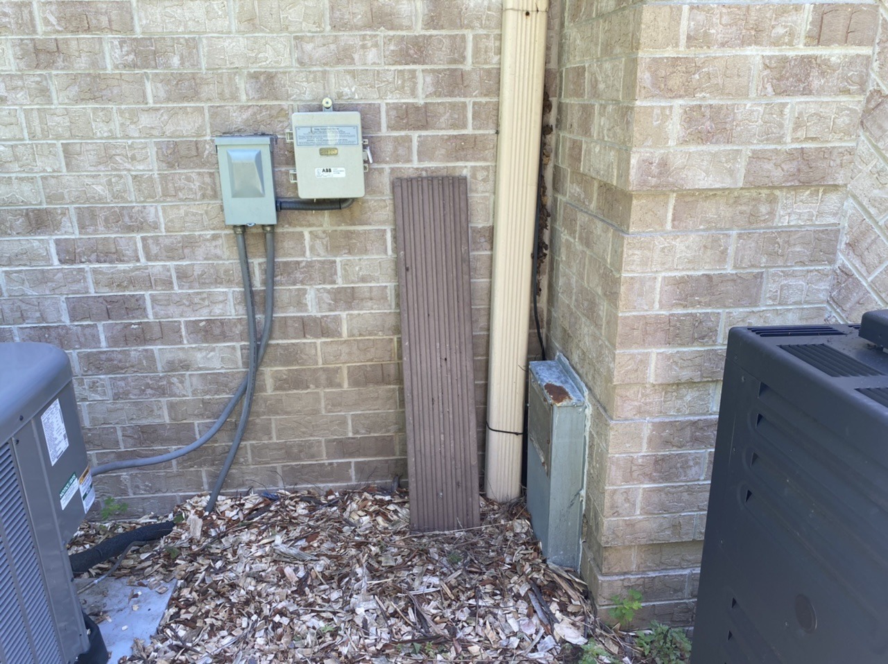

A photo of the downspout I'm looking to use is below. I plan to have the waste line run low along the ground around the corner of my chimney, around the metal box (which was probably an air intake for the chimney at one point but now seems to be sealed up with concrete), and into the downspout. Is there a better way than just cutting a hole in the downspout slightly larger than the pipe, having the pipe go in to the downspout by 1/4" or so, and then siliconing the Crud around the opening? I doubt anyone makes a downspout tee to a 1.5" PVC connection. I could put unions on this run so it can be disconnected if necessary, too, and put one union right by the downspout. Any suggestions?
Photo of the downspout to left of pad:

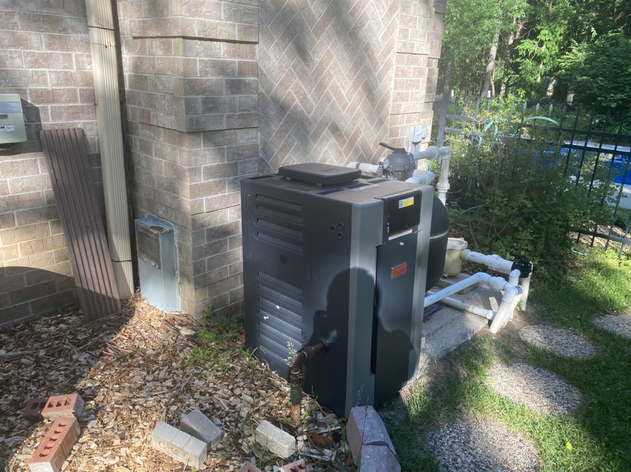

Further back (you can see the waste line coming out toward the house from the MPV):
