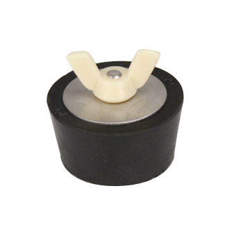

I have tried one very similar to that one, just from Menards.
It is not long enough and will not go deep into opening enough. Any slight pressure against it , when frozen water around it from my experience, it will just pop out. plus as mentioned turning to rust, it is straight metal and plastic, not stainless. here is a link to an ebay post for one that I have used with great results.
I use 1 1/2 inch but you can search for 2 inch.
If you can use a non threaded style , this one goes deep into opening and will not corrode.
Anderson 145N 1-1/2 pipe Nylon Pool Winterizing Pool Test Plug 852673923540 | eBay
I wonder why they call them “test plugs”. Would think winterizing plugs would be a better name? Test plug sounds like they aren’t sure if the plug will do the job.
I believe it is a test plug for a straight flush PVC. Remember that pool return fittings are threaded and the black plugs expand to grab the outside so no air escapes and water enters.
Can you expand on the reasoning for the wingnut position? This is the first I have heard of this.
Advised of this from PoolGuyCT. Considering his knowledge and background, I will not doubt him. It has to do with the water level possibly freezing and somehow putting pressure on the plug. The North to South will put more pressure away from the water level. My best guess.
