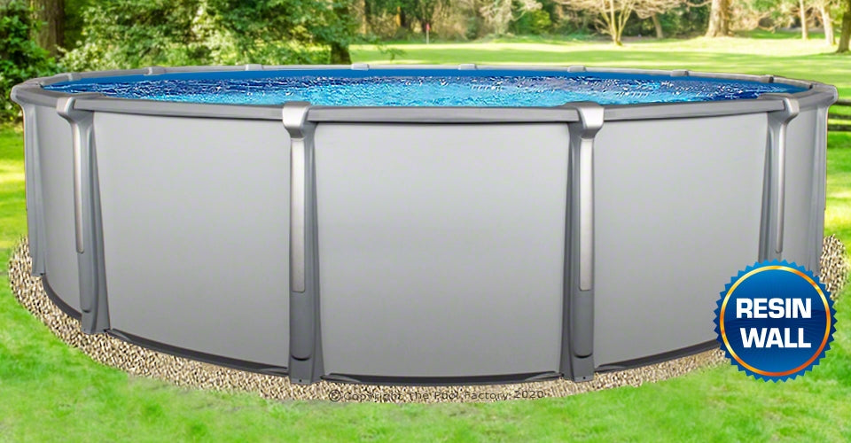

They are making resin walled pools now. Some members even have them. @jcp is one
Reactions: Mdragger88
I just wanted to chime in that they make resin walls now, but NewDude already did! I am saving my pennies for one of these next year.
