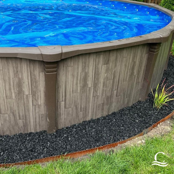

I ended up going with the Carvin Woodstock in the above post and just received delivery today! The all resin Aurora was very tempting, but I just love the looks of the Carvin so much more. If I get 10-15 years out of it and I will be happy.
I bought an SWG as well, so next step is advice on reconfiguring electric and plumbing to accommodate.

I really love the look of it, and guess I should replace my avatar.
I got it at American Sale which is a smallish (5 stores?) chain local to the Chicago area
