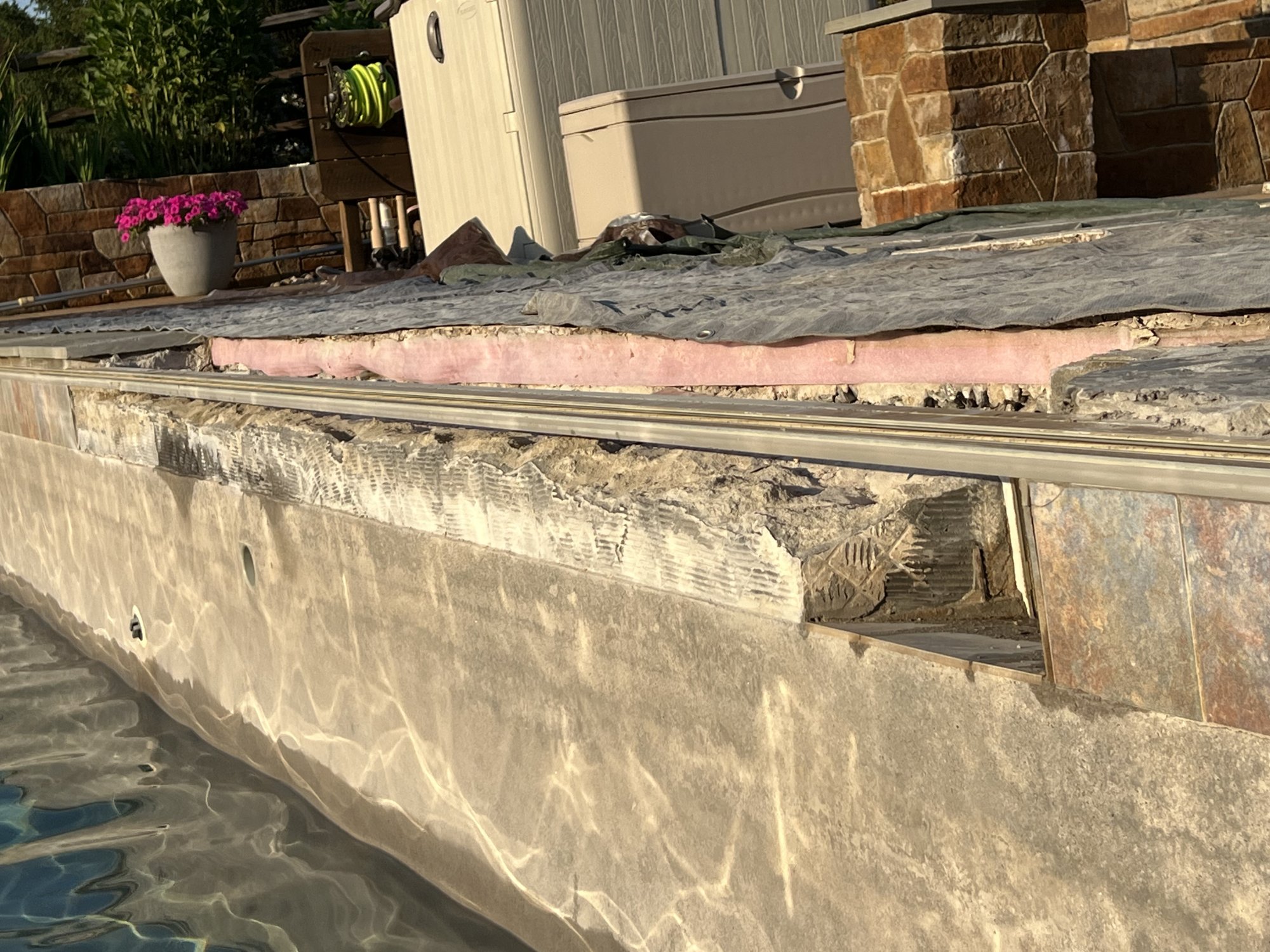

Hi All, around half of my pool deck has settled, I believe from 2 leaks I had 2 years ago. The man I hired to repair the deck after the leaks were fixed is doing the work. They will saw the existing deck to break it up for removal. What I’m wondering is if there is anything I can/should do to keep the dust and pieces of concrete out of my pool. It is a free-form pool so it might be difficult to follow the contours and the pool will still be open as I normally close it in November. Any ideas are appreciated. I’ve added a few pics of where the deck has lifted off the beam. IMG_1999.jpegIMG_2001.jpeg

Thank you for responding. You had quite a bit more going on than I do, I think. I guess we’ll see when they take the deck off.
I’m trying to do this with the pool still in operation as the water is too warm to close. Last year I closed early and opened late and I’ll never do that again! I will get with the contractor and see if he is planning on using anything to keep the debris out of the water.
