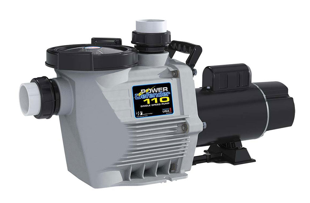

Waterway has a PD110 pump that is DOE legal, single speed and can run on 110v. I have installed 2 so far and they are a great pump.
Example:
