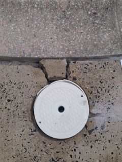

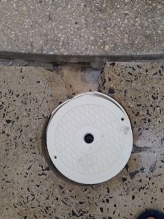

The question I have now is about the Skimmer at deep end. Please see pictures (via photo bucket). As you can see, a small piece of concrete from the top of the skimmer has completely separated. It’s just now sitting there, I can pull it out and top of the skimmer becomes uncovered.
I have following questions:
1. How do I repair that specific spot on top of the skimmer?
(a) Remove the piece, use concrete mix to fill that spot, and then pour Deck-o-seal in the remaining gap by the coping?
(b) Do not remove the piece and only use Deck-o-seal all around it (not sure if this going to work)?
(c) Remove the piece, do not use new concrete, and only use Deck-o-seal for that entire area on top of the skimmer?
Thanks for reading and appreciate any advice.
