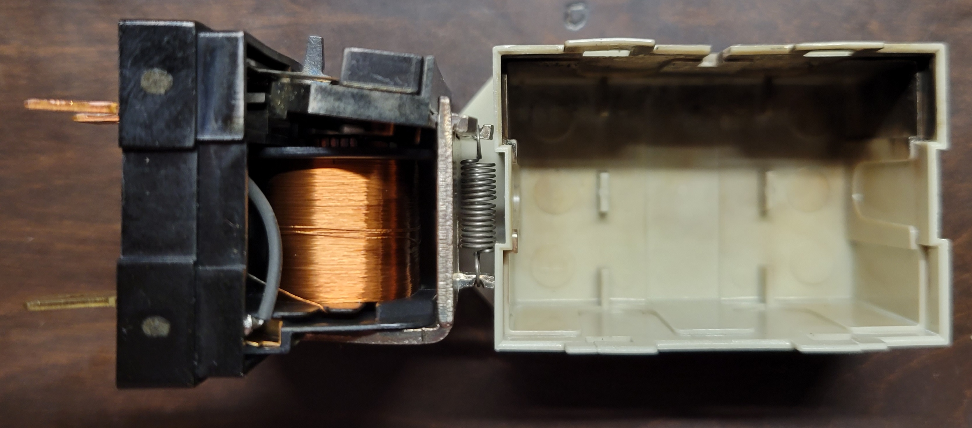

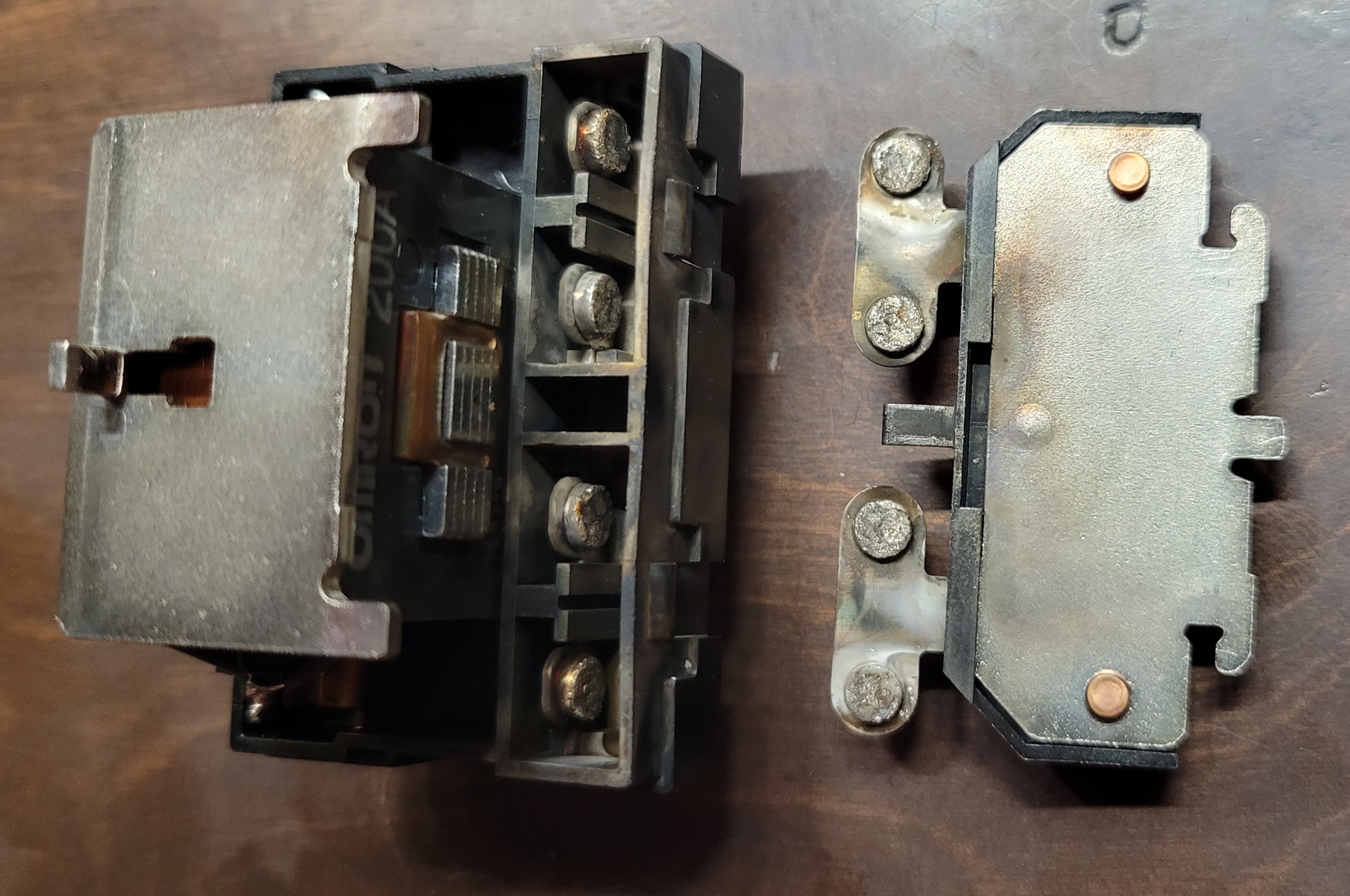

Lots more poking with the multimeter this time around. I took the timer cover off and there she was, an obvious scorch mark on the case where the relay had given up the ghost.
Oh yeah, she toasty! Contacts are done for!
Anyhoo, the $20 replacement from Amazon will be here in a couple days.
I guess the magnet gets weak over time and it can't close the circuit?
Omron G7L-2A-TUB-J-CB-AC200/240 General Purpose Relay With Test Button is the Relay info for those googling to this thread, purchased @ Amazon
