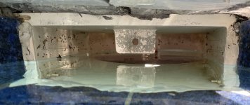

Because a planned tile repair will require draining below the tile line, was considering re-doing a patch at the skimmer/gunite interface. Not leaking today, so bad idea? If not, what epoxy or sealant is recommended? Got to adhere to plastic and gunite; resist water, chlorine, salt; and ideally flexible enough to accommodate expansion differences between plastic and plaster. And, cure fast enough to not leave the plaster exposed too long.
A year ago, a leak repair guy found the leak (700 gallons / day!) at the interface between the plastic skimmer housing and the gunite and fixed it using 2-part underwater putty. But now when I touch the repair, I get a white cloud, making me think the epoxy maybe did not cure properly. Or at least does not seem a permanent seal. Ain’t broke, don’t fix it, but worried this will begin leaking again, especially after reviewing TFP and seeing periodic repair is typical for skimmer leaks. A dry surface seems the best opportunity to do a near-permanent repair. But – always a chance for making things worse, schlimmbesserung. Tried to include a photo, but difficult with the water interface.
