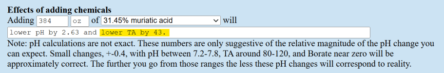

@JoyfulNoise @JamesW What would you say the pH was at opening if it took 3 gallons of 31% MA to lower the pH to 7.5? TA 70 and 75 PPM of borates.

This note does not apply to that amount of pH change and the calculation is reasonably accurate?
Results are approximate and can be off significantly for large pH changes.
So the Old Pool Math page works better for this type of change then Effects of Adding which tells me each gallon lowers pH by 0.9. 3 gallons should have lowered pH by 2.6 or 2.7 according to PoolMath app Effects of Adding?
That did not pass a reasonability test that pH could have been around 10.
Was the 70 TA before or after adding the acid?
After. Didn't test before beginning the acid additions.
I closed at TA 70 and my fill water is about that.
Pool took the same 3 gallons of MA at opening last year.
I wish that @chem geek had taken this table out to pH in the high 8's.
It does look like pH 8.3 would be equilibrium around TA 70-80.

Fill water TA is 90.
I added about 25% of the pool based on closing salt of 3,000 and opening salt of 2200 after filling the pool.
So TA at opening should have been around 80.
Borate makes a big difference.
With borates, the starting TA was 113 and the starting pH was 8.26.
Without borates, the starting TA was 113 and the starting pH was 9.9.
That is VERY interesting.
At April 2024 opening I had some winter scale with the pool taking 3 gallons of MA without borates.
I added the boric acid in September 2024 and this year it wintered with borates and had no scale upon opening. Still took 3 gallons of MA at April 2025 opening.
I think this demonstrates the reason borates can prevent high pH in a closed pool and winter scaling.

70 + 43 = 113.
If the TA was 70 after adding 3 gallons of acid and 3 gallons of acid lower the TA by 43 ppm, then the TA had to be at 113 before adding the acid.
Most likely, you had some hydroxide and carbonate from the plaster that raised the TA and pH.

Note to self - test TA at opening in April 2026.
