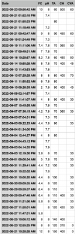

Hey all, I feel like we're getting the hang of things now that we've been maintaining our pool ourselves >1 mo. now. I have a few Q's I'm hoping the experts can share their insights on:
  1. Our CYA seems to be in a good place now at 60. My limited understanding of CYA is that there's no way to get it out of your pool once it's in, but does it diminish over time or should we anticipate it more or less stabilizing at 60 now?
  2. It feels like we are constantly adding muriatic acid to keep our pH in line. I checked and so far for the month of Sept. we've added 2 gallons, 3 quarts. I keep reading that this is relatively normal for summer and for a new pool (ours was just opened in March). Keep in mind we are in Austin and so unlike some lucky northerners, we are nowhere close to "fall" weather. Still very hot. Is this "normal" to add this much this often? I'd say we add acid every other day or so based on what Pool Math recommends.
  3. Our FC has been increasing this week. I don't even know the last time we added chlorine- months ago for sure. We have a SWG and to be completely honest I don't know much about it though under the Chemistry tab on the IntelliCenter2 app that we use, there is an area for IntelliChlor where we can change output. For a long time we had it at 100% and then when our chlorine got where it needed to be we dropped it to 50%. We've had it at 25% for about a week now and I'm wondering if that needs to be further lowered? Pool Math indicates our FC is outside of the recommended range and it recommends SLAM (which I've never done so maybe more questions on that!), BUT it also says: "There is no recommended chemical to lower FC levels. Exposure to sun can help to speed up the process." That last part confuses me because we've had nothing but exposure to sun every day. So I'm confused about what to do here re: FC.
Finally, here are our latest test logs:
And once again, many thanks in advance!
It drops over time. Check it once a month (or less if you find it's not dropping enough each month to merit testing each month). And be sure to check it in the Spring before the summer heat starts.
  1. It feels like we are constantly adding muriatic acid to keep our pH in line. I checked and so far for the month of Sept. we've added 2 gallons, 3 quarts. I keep reading that this is relatively normal for summer and for a new pool (ours was just opened in March). Keep in mind we are in Austin and so unlike some lucky northerners, we are nowhere close to "fall" weather. Still very hot. Is this "normal" to add this much this often? I'd say we add acid every other day or so based on what Pool Math recommends.
Normal is what's normal for your pool! Trust the testing. Dose as needed. My "new" finish, after five years, still drinks acid as much as ever. It has to do with the high TA of my fill water. It's why I automated acid dispensing. Your pool is going to need what it needs. Your TA looks OK, so your acid consumption is going to be what it's going to be. You can wait until next year to see if it's going to come down any. Or at any point we can talk about automating acid dispensing if you tire of doing it manually.
