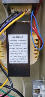

Show me pic of where the SWCG transformer wires (Yellow, White, Violet/Blue, and Black) go.
Jim R.
From the relay, the black wire goes directly to the light transformer box mounted beside the main panel.
The blue wire goes to a wire nut with 2 other black wires: 1 of them goes directly to the breaker for the lights, the other goes to a second wire nut.
The second wire nut has the yellow and black wires from the SWCG transformer in it.
The blue and white wires from the transformer go into a wire nut with another white wire (i believe the neutral) which is wired to the same light breaker.

419,
Wow!!
Please tell me who wired your system?
Unfortunately, it is not even close to being wired correctly.
If you are trying to do a DIY install, we need to see what we can do to get it cleaned up.
If a pool guy or electrician, did it, please never let them touch it again, as they have no clue what they are doing..
Some of the stuff that I see wrong.
1. The relay in the upper left of the IntelliCenter is supposed to be the Pump/Filter relay NOT the light relay.
2. The SWCG Transformer is supposed to be wired to the Load side of the Pump/Filter relay and it is not. This prevents the cell from exploding if the cell gets power with the pump not running. Your SWCG transformer is powered all the time.
3. The Light needs to get power from the load side of an AUX relay, not the Pump/Filter relay. The light is currently wired to the Line side of the Pump/Filter relay.
4. The SWCG transformer does not need a GFCI breaker.
5. The Pump/Filter Relay should have AC power on the Line side of the pump relay which it does not.

Talk with the pool builder and tell him you want it wired correctly. Tell him you want a different tech than the one who wired what you have now.
Just look at the note on the SWCG transformer. It specifically tells you how it MUST be wired.
