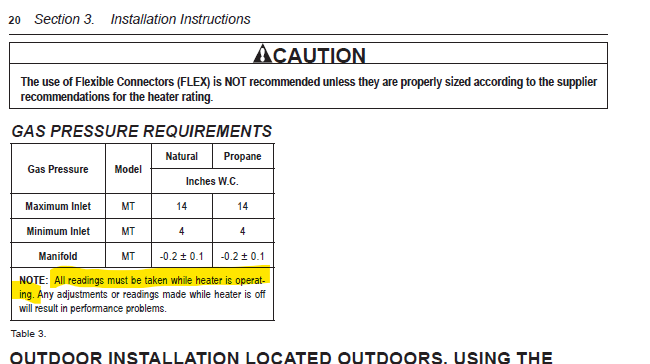

6. I tested the gas pressure coming into the inlet side of the gas control valve with an analog manometer. It started off at about 10in./wc before I turned the heater on, when the heater lights it drops to about 4 in./wc and when the heater shuts off the pressure goes up to about 15 in./wc. Then the heater will try to light again and it will drop to about 4 in./wc . I read its not suppose to drop more than 2 or 3 in./wc when it lights but it still should stay on right, just burn rich.
6. I tested the gas pressure on the manifold side(see video) below it does not drop to a negative reading when it fires up.
