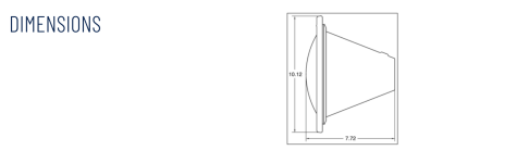

Thanks for that info, I was measuring the inside diameter. The OD on mine is indeed 10" and the housing does say Amerlite on the inside.
