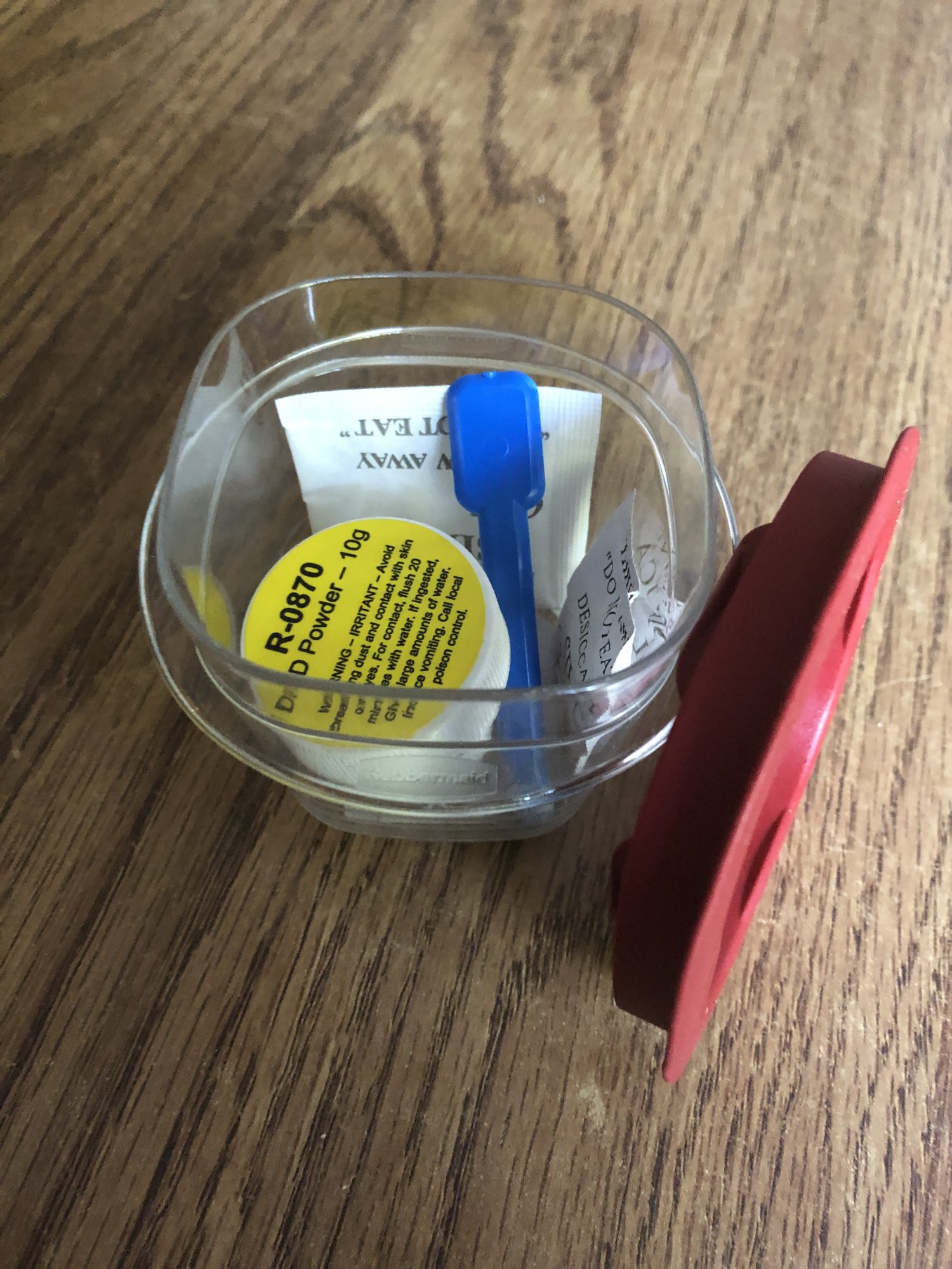

Old claggy DPD powder
Every test I've done with a DPD No.1 tablet in place of the powder has come out the same. Admittedly, I only do a 5ml test also (1ppm/drop) because I just don't need the 0.5ppm resolution and my FC is always > 7ppm. Saves me a lot of titrant.

I wonder if you can "recharge" the desiccant in a used up DPD bottle so you could move some to it from a new one ... just to keep from having to expose all the new powder every time the container is opened?
edit: For concern over using up supplies, I find that I don't need two scoops of the powder. About 3/4 of one scope reads exactly the same, at least at the ranges I keep testing.
