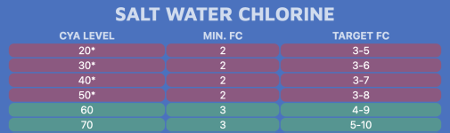

Dose to high target for your cya with liquid chlorine & see if your swcg settings maintain that. Rinse & repeat daily adjusting as necessary until they do.
FC/CYA Levels

So my target FC will be (for now) between 4-9

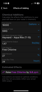

I have my pump running 24/7 now so based on that and the pool math calculator I set it to 27% to generate 3.0ppm of Cl over 24 hours.
