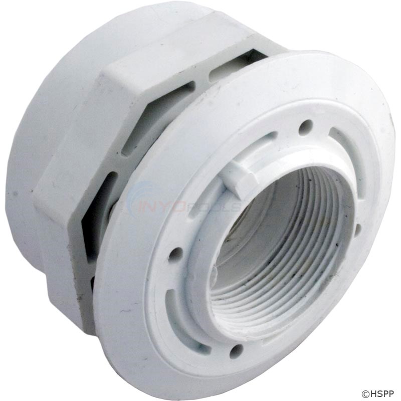

However, while looking for the screw holes with my hand, I came across a bump in the way. Fortunately, I took pictures before and found out that there is a plastic tab on one side:
That's when I understood why the previous face plate was broken: the previous owner tried to screw the face plate but that tab was in the way and broke it.

Maybe this:
Maybe this:
Hi @JamesW
Yes, indeed ! I think you nailed it. I looked at other pictures I took from different angles and the tab that I previously thought was only ~1mm thick is actually full like in that picture.
So, the previous owner used another model of fitting than the two return jets for that one but tried to put the same face plate (Hayward SP1408B) thus breaking it while tightening the screws...

That port is not a return. Here you can see in green the two return jets, and that port on the side in red:
From what I have read, it might be a "vacuum port" that is connected to the bottom drain. However, when I open the second hole in the skimmer connecting to the bottom drain, there is no succion from that port. Maybe it is blocked by something. So mostly, that port doesn't seem to be "active" in the system.
If that is the case, can I just leave it covered with the patch like it is right now ?
