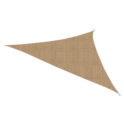

I'm thinking blockade (I'll keep the military theme going)! Can you erect a shade sail under the tree, between it and the pool. That would provide additional shade, which you seem to like, and help, possibly eliminate, the fallout? Size, position and angle it such that it catches most all of the bombardment and the shrapnel is directed away from the pool, ideally to dirt. What doesn't slide off might be encouraged to do so with a quick shake. Or a good hosing now and then. If you don't have any way to support a shade sail, I can give you some ideas about that. And where to buy a good one, too.

Jokes aside, I do really like the shade sail idea. @Dirk Can you suggest good places to buy them?
I have what I think are the best. From Shade Sails. They're not cheap (hundreds for even a small one, not counting hardware). Nor down and dirty to install. They're structures, and they need to be supported and tensioned properly. But they won't flap around in the wind, and they'll last a long time. They'll even make one for you to the exact size and shape you need.($$$)
OR
You can string up one of those cheap blue tarps, or a cheapie shade sail from Lowes or HD, and do a proof-of-concept trial. See if a barrier will solve the problem, and put up with a little flapping noise (but not loose enough to flap collected yuck onto the water). If it works, then you can get a nice one. Target has 'em, too, $26.
