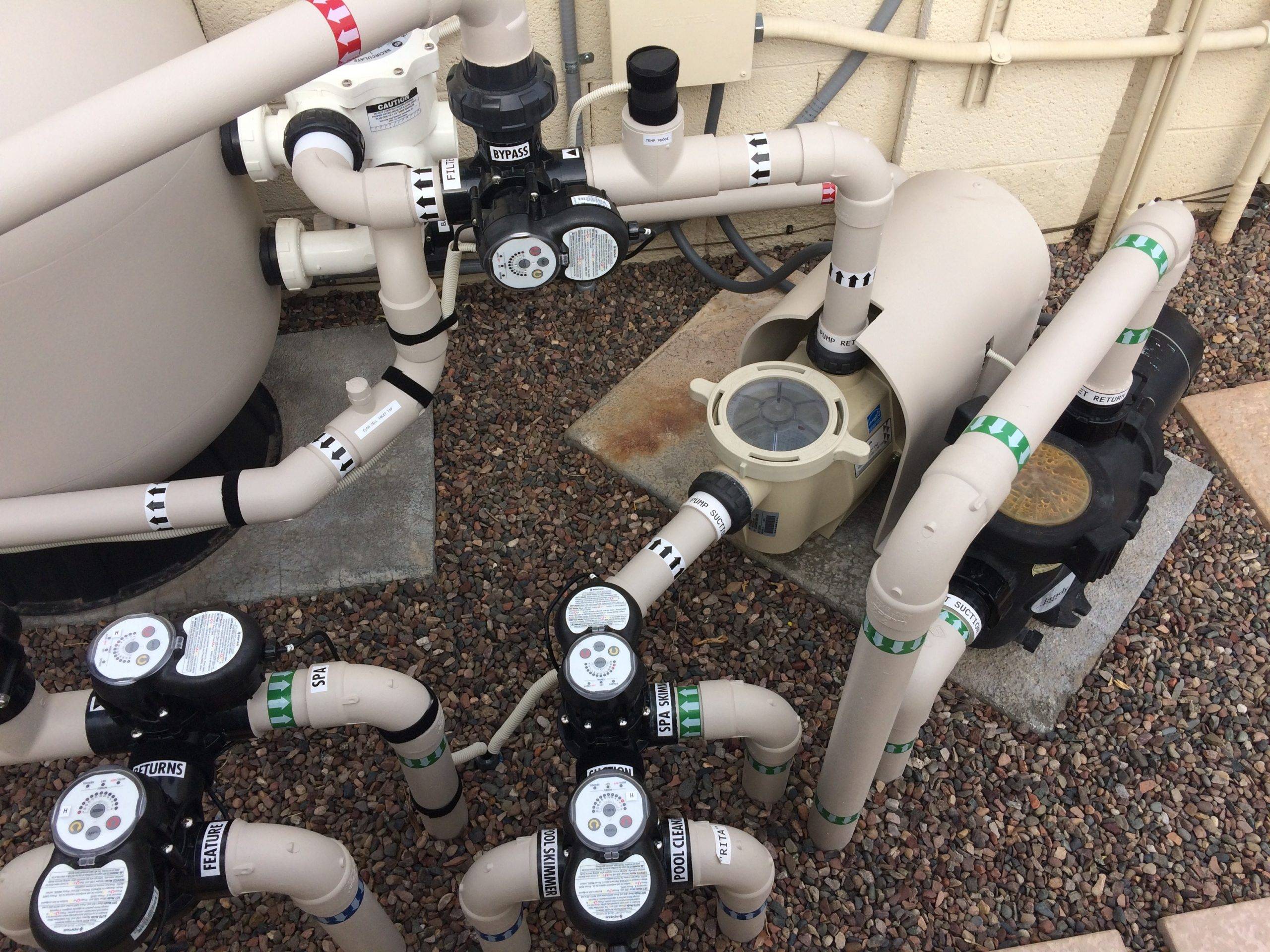

Pentair Intellichlor IC-40
I just installed a Pentair IntelliChlor 40 and am trying to get my levels where they need to be post-conversion. FC is at 1.8 this morning, and PoolMath tells me to run the pump at 91.5 hours at 8%. Why wouldn't I run it much higher for a shorter time to get the FC up to my target (5 PPM)? Thank you!
