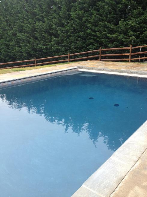

I just examined my finish closely, not a mottle in sight. I tried to get a pic, but the pic is reflecting our cloudy day today, which looks just like bad mottling. Sorry, no help there. All I can do is say that it looks nothing like this in person. You can kinda see in the reflection of the trees, which are blocking the clouds, that the finish looks pretty even, though some light is sneaking in through the branches, which looks a bit like mottling! Whaddayagunnado?
Thank you for the photo Dirk. Your finish does look great! Hoping ours gets there.
