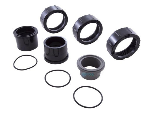

I have 2.5” fittings connected to the unions. Heater is a Jandy. I need two either replace the section with two unions and the back flow completely add an injection point after the chlorinator but the fittings almost butt up to each other, not enough PVC to use.
Can anybody ID the union parts I would need to order?
Any suggestions on how to do this alternatively (Adding a stunner pump injection point after the tablet chlorinator).

Thank you! I saw the 2” and wasn’t certain it would fit because it’s hooked up using 2.5” fittings.
2" slips on the inside.
2.5" slips on the outside.
Your 2.5" fitting all are on the outside.
