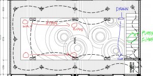

I want to share my findings on my 2nd pool in Bali, where the plumbing + pumps + filter system I design/choosen.
Size wise and shape I can't do anything about it. The availble space "X" size and condition "Y" is a given non-negotiable.
Also due to limited available space, I can't go overflow system but has to accept a scupper version pool.
The pool is too small to do any proper swim. Its only 3.7 meter wide and approx 9ish meters long.
Deeper zone is only 130cm and shallow zone is a "beer drinking" shallow.
Initially it was supposed to be all 130cm deep but last minute logical change for "beer drinking" shallow zone.
Unfortunate screw-up occured here, by one of the worker.
I ended up with lost of 1 suction floor drain because of the already placed suction floor drains (total 4) on
the now shallow zone ( 2 drains ) has to move to deeper zones. That lost 1 drain is clogged to death by I am sure
concrete 2nd pouring to shallow that zone. Anyway there was nothing I can do when pool completed its only then known.
Sept 2017
Sept 2017 - The last minute shallowing made the pool WEIRD and not too comfy due to the edges.
The "beer depth" is when I sit on my butt on the floor, my arms can open wide and rest on the wooden deck with comfort,
I think its like Jacuzzi depth.
