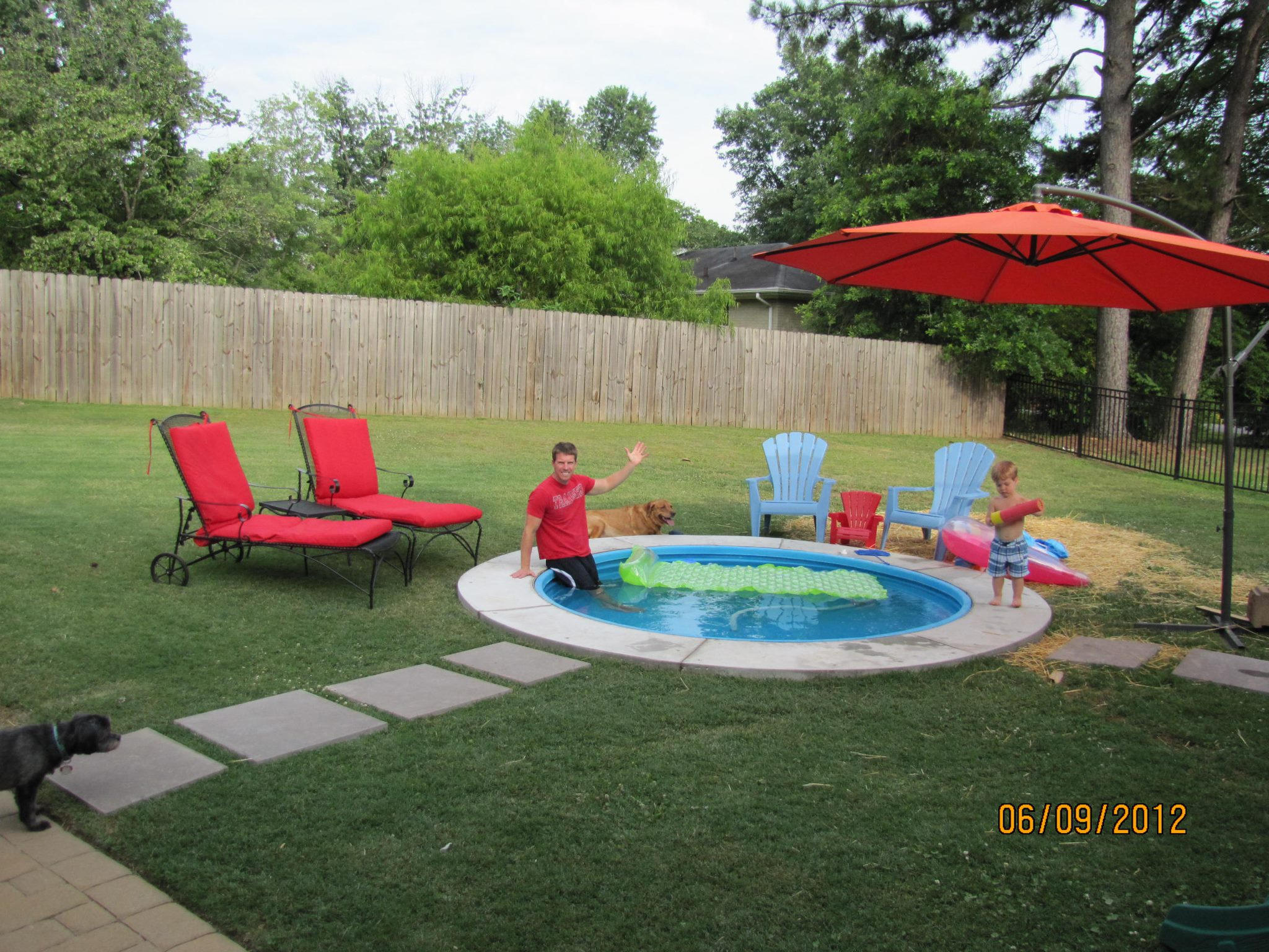

I built my mini-pool when my son was two. Now he is 7 and has two younger brothers (5 and 2.5) and we are planning on a bigger pool. This is a 10' diameter polyethelene livestock tank. I plumbed it and have a nice pump/filter to keep it clean. This pool has been awesome, cost less than $1k total, and our family has gotten a ton of use out of it.
I am having some difficulty in deciding concrete (gunite/shotcrete) vs vinyl. In particular, weighing the ability to get exactly what I want and the increased maintenance/chemicals for concrete vs the lower cost and simplicity of a vinyl pool. I grew up with a 15'x30' oval vinyl pool, and my sister and I spent the better part of a decade in that pool. LOL...my dad started the dig with a shovel and got about 1/3 of it done before switching to a bobcat and finishing. But I see some of these amazing concrete pools and I just want-want-want them! I intend to DIY while hiring out some of the stuff, for example, rebar/shotcrete/plaster if we go concrete. In terms of shape, a modern rectangle would be my preference.
333371_3177296671902_1625568889_o by scooter_ball, on Flickr
11018093_10204136242186868_1620461955074943473_n by scooter_ball, on Flickr

That is the coolest fun-sized pool!! Way to go, Dad! Your pool should be on Pinterest. And look at those fellas, just beaming!

I can tell from your photos, this will be a fun build - vinyl or plaster!!!
