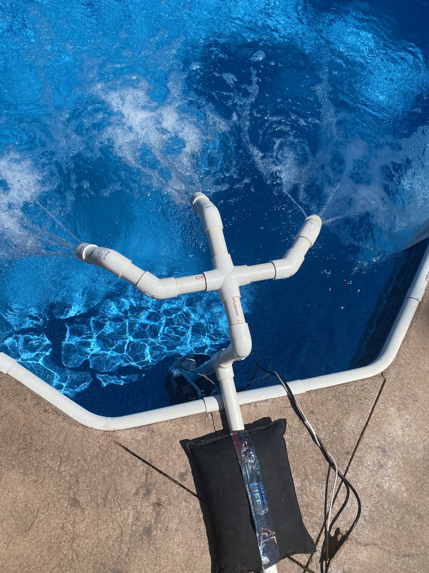

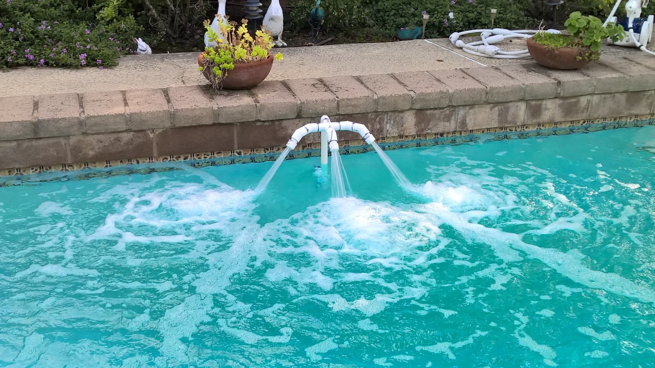

When I first came to TFP, my TA was high due to prior owner's keeping it artificially high due to the use of acidic pucks (my fill water is 80). I found this aerator, that the member made and put on their return:
I didn't want to have to swap this contraption with the return eye. I also wanted something that was portable and easy to use. I got a sump pump, and built the same thing with 1.25" PVC. A 1/3hp pump is plenty big and typically come with a 1.25" male thread. Get a 1.25 Female to 1.5" SLP adapter and thread it on the sump. Build up from there. The elbows are 45s, and the end caps are drilled with 5 to 8, 1/4" holes. The sump pump is put in a bucket to protect the pool surface. I tied a rope to the handle of the bucket, and used electrical tape to attach the power cord of the sump pump to the rope, so the rope has all the tension when lowering and raising the bucket. Make sure you purchase a sump pump with a 12' cord, to keep the connection to any extension cords away from the pool. As always, when there is an electrical device in the pool, PLUGGED IN OR NOT, NO SWIMMING! Sump pumps can fail. We do NOT want electrocutions!!! NO EXCEPTIONS!
In my 30K gallon pool, I can reliably lower TA by 10, in 12 hours. If your pool is 10K, you should be able to reduce TA by 10 in 4 hours (get the connection?) I cycle between 7.0 and 7.4, because CO2 outgasses at the highest rate with this pH. As the guide indicates, 7.6 is fine for the top end too, but as @Newdude says, "I'm 'extra'." When your TA approaches 80, STOP forcing pH down so low. With a TA between 60-80, pH should be fairly stable around 7.8 to 8.0, which is just fine!
