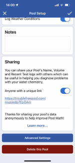

Can you not see my PM log link? I thought I had it enabled.

Nope, can't see it. In PM, click the settings gear, scroll all the way down, and enable "Link from TFP.com user profile". Then click the check mark and we should be able to see your logs.
Yeah, I used to have that option. I don’t see it now.

No, it sure wasn’t. Weird. I think maybe it changed back when I had some issues with my subscription syncing with the app. Anyway, I did a backup out of the old account, but when I try to import it to my linked account, the app crashes. Darn.
Never mind, figured out the issue. Duplicate pool names when I was trying to import. Alright…so, back to my original question…
