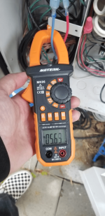

Error 120 and 121. Cleaned cell with hose although it wasn't too bad. Lasted another week and now error 120.
37.4v between one prong and the center of cell
37.6v between the other prong and center.
77 mV when measuring the 120 m VDC points on the board.
PIB also properly configured for 1400 cell (jumper not broken).
Cell 2.5 years old in Florida. Is that really all I'm going to get?
Pump runs 24/7, 1100RPM at night then usual schedule during day. Cell 50% in summer, 20% in winter. 16k gallons. 3200 ppm salt w/ k-1766 test.
All signs lead to replacing cell unless I'm missing anything else?
